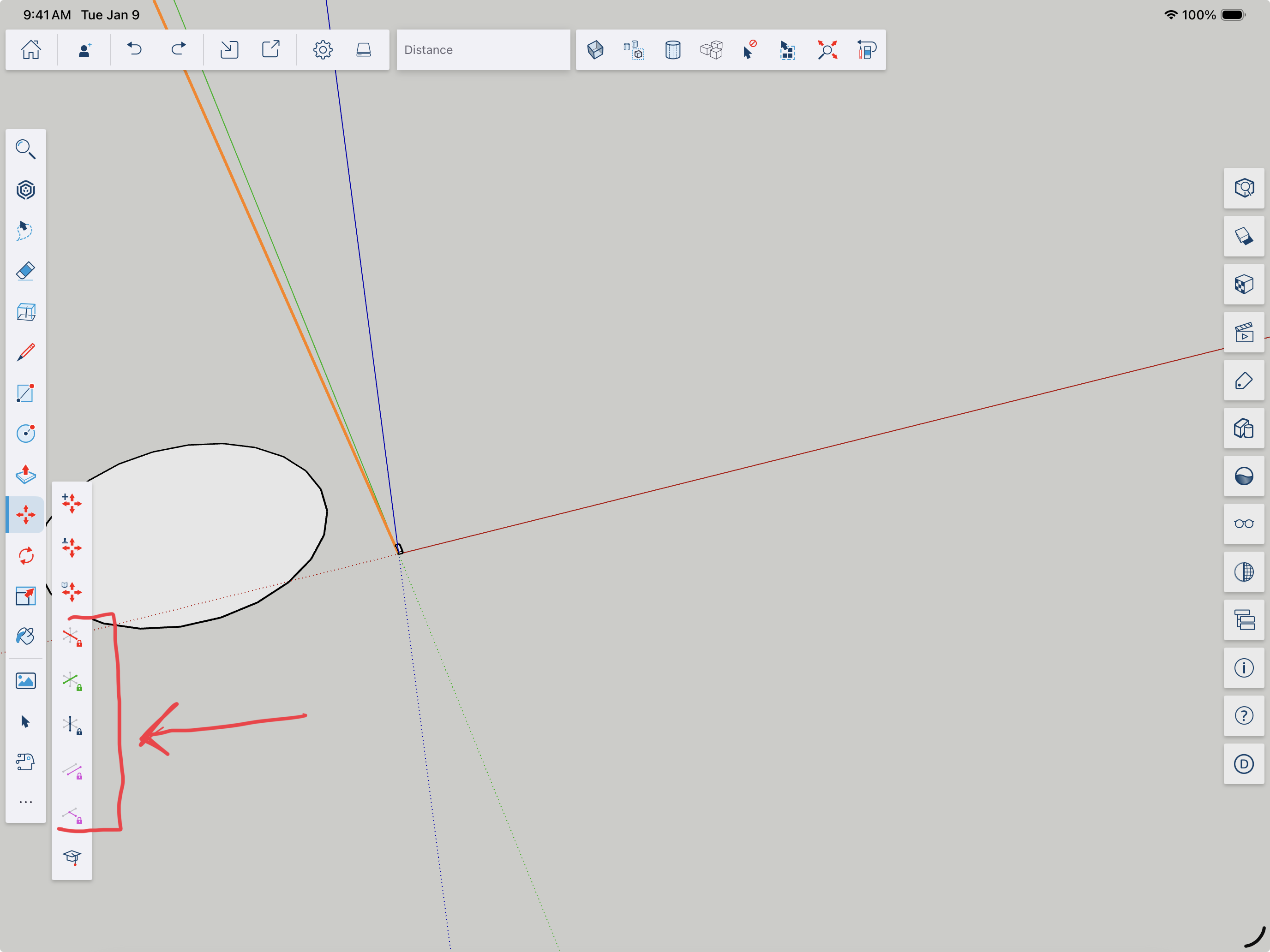

Is there any opportunity for Inference locking on iPad Sketchup? Locking to faces and lines?
@dr.trufanov Inference locking does indeed work on iPad now. For tools where inference locking is important (like the Move, Line and other tools) you will find sub-tools that will automatically lock your action to a model axis or nearby line. You can also invoke these inferences dynamically by using the arrow keys if you have a keyboard attached to your ipad, the magenta lock will work with nearby faces and lines.
