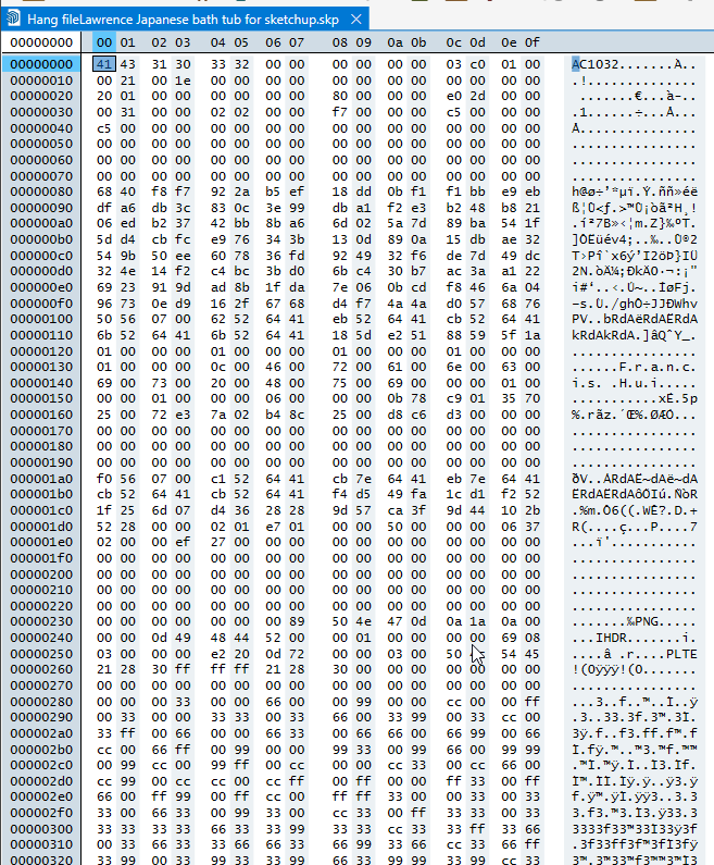

It’s nearly 30% zeros and the first part is missing.
This is the first part of your file in a hex editor.

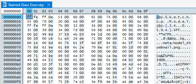

The first part of a viable SketchUp model looks like this in a hex editor. On the right you can see it says it’s a SketchUp model.
