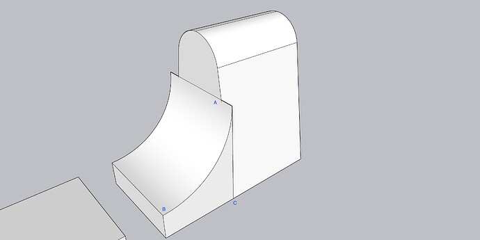

As shown on attached drawing I need to connect the “A” point with “B” point mainteining the proper curve and without moving point “C” with consequent removal of the area in excess. Is there anyone able to provide me support with detailed step by step process to get it? Many thanks for your kind attention. Kind regards. Mariagrazia

Hi Mihai, sorry for coming back to you with further question. I followed your procedure but I found out the problem showed on the attached screen. Probably I’m doing a wrong command. Could you please let me know what’s wrong? Many thank again. Mariagrazia

I used E to erase certain edges and Ctrl + E to soften others.
An alternative way using Subtract from the Solid Tools. Model the object as a solid and then a “cutter” volume as another solid.
subtract
