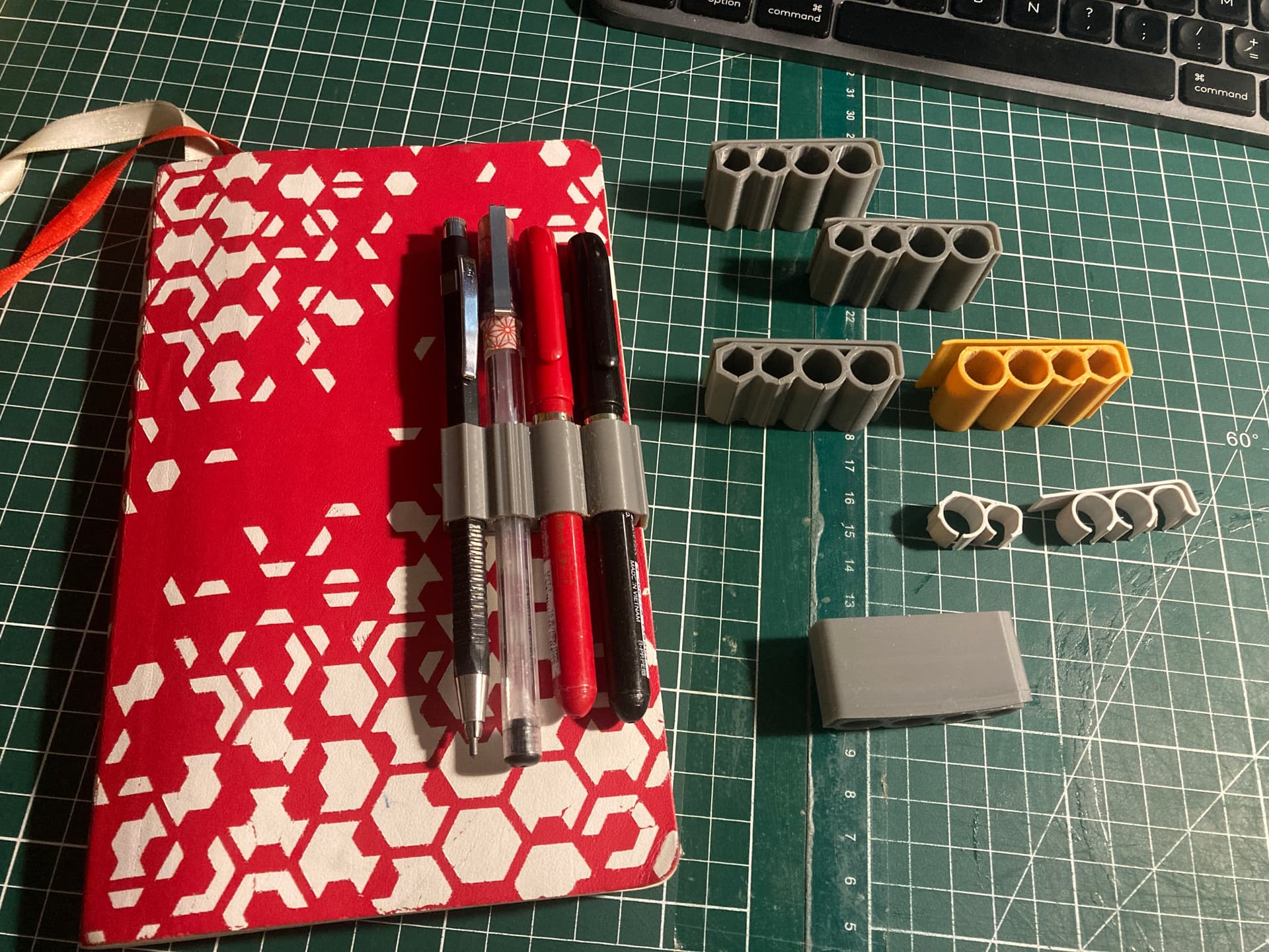

I mentioned the penclip earlier,
it clips on the cover + a couple of pages, it contains all I need on a daily basis, pencil, pen, couple of felt pens.
at first I tried to make it thin and open, slightly smaller than the pens. but it caused deformation on the long run, and thin = fragile.
then I tried various thicknesses, with and without an opening. did maybe 15-20 print test of just rings to see how much printing and cooling would affect the final size (because plastic expands and shrinks, the dimension you type in is almost never the exact end dimension. and when you’re talking 1/10th of a mm for a good fit, it matters)
in the end, I printed one juuuuust a bit too tight, and filed / sanded each tube so they would grab the pens but still allow me to get them without too much force.
I’m keeping the others, they are a bit too tight, but if I break or loose the current one, I can simply re-adapt them.

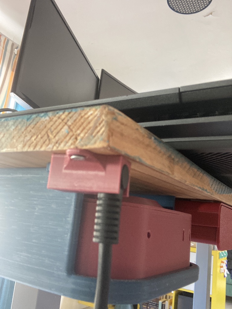

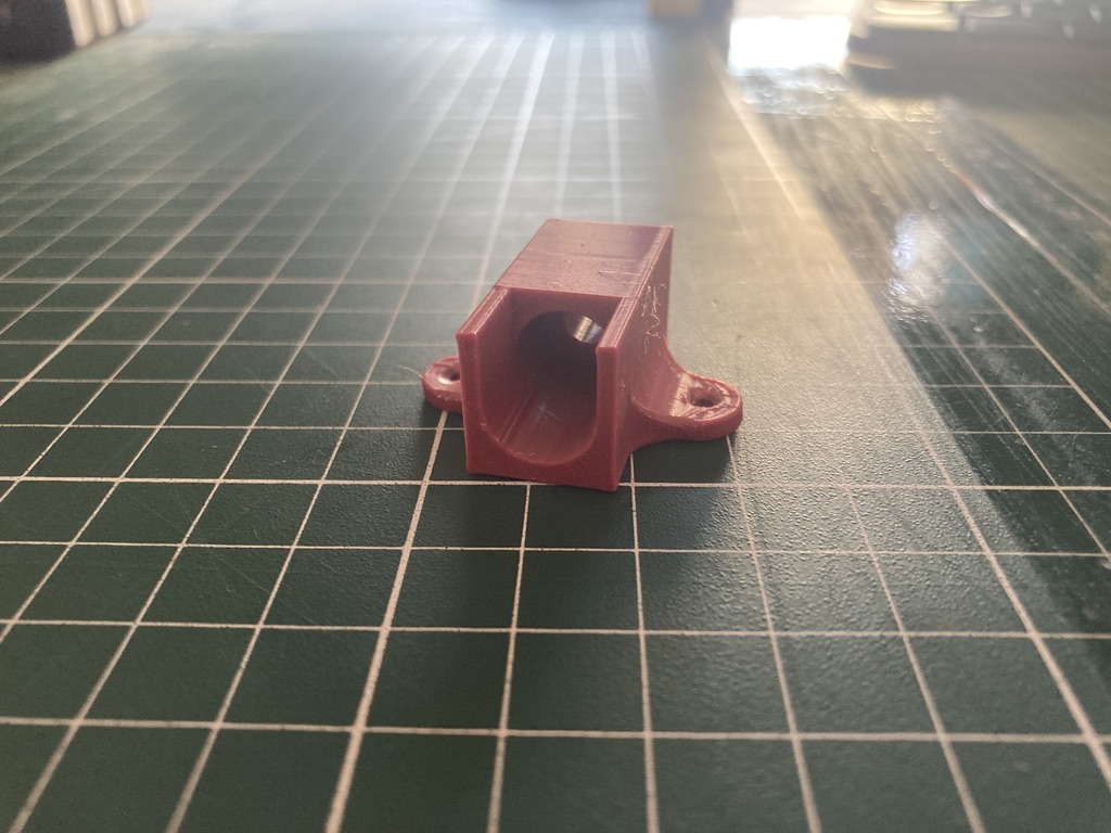

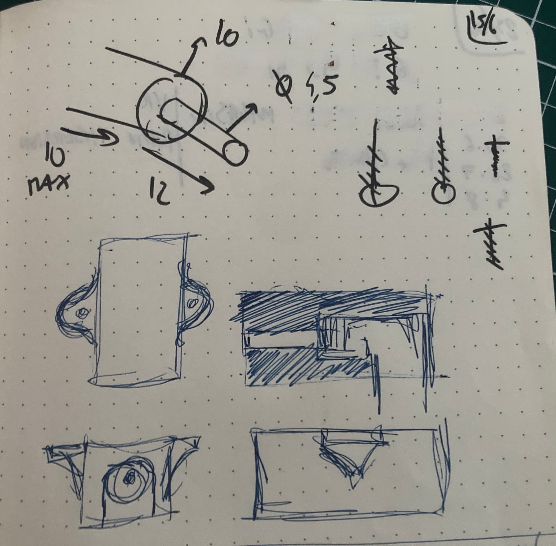

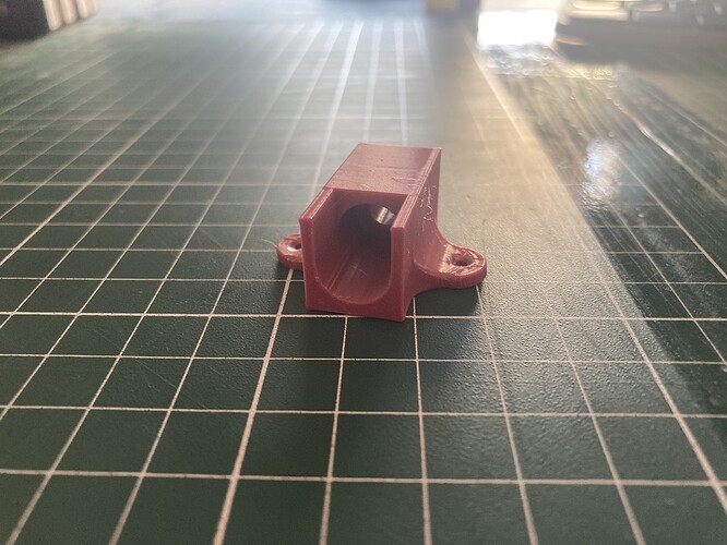

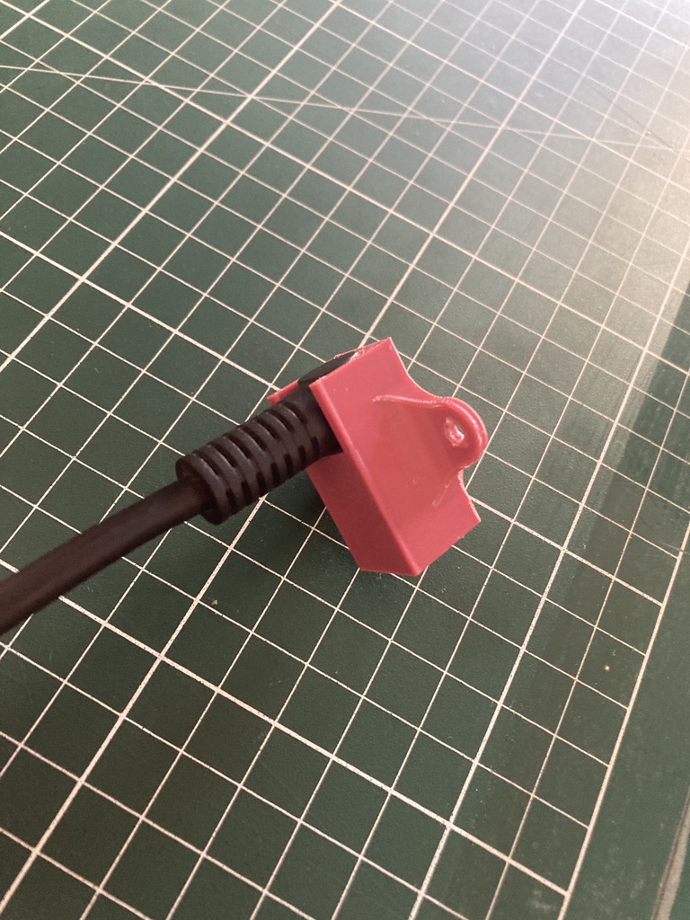

by default, my PC is on my desk, with its charging cable. whenever I use it somewhere else (couch, bed, rowing machine, balcony…) I usually leave the charge cable. and no matter where I try to put it, it usually ends up on the floor.
so I took some basic dimensions, made a 1:1 (sorta) sketch
from there, a quick model with whatevec PLA was loaded. a pair of tiny screws, and I have a place for the cable to rest when It’s not pluged in my laptop.
(next to it, I thought about having the mac mini under the desk but in the end, nah. so I printed a fake mac mini and I used it as a drawer. you can take the top off.
