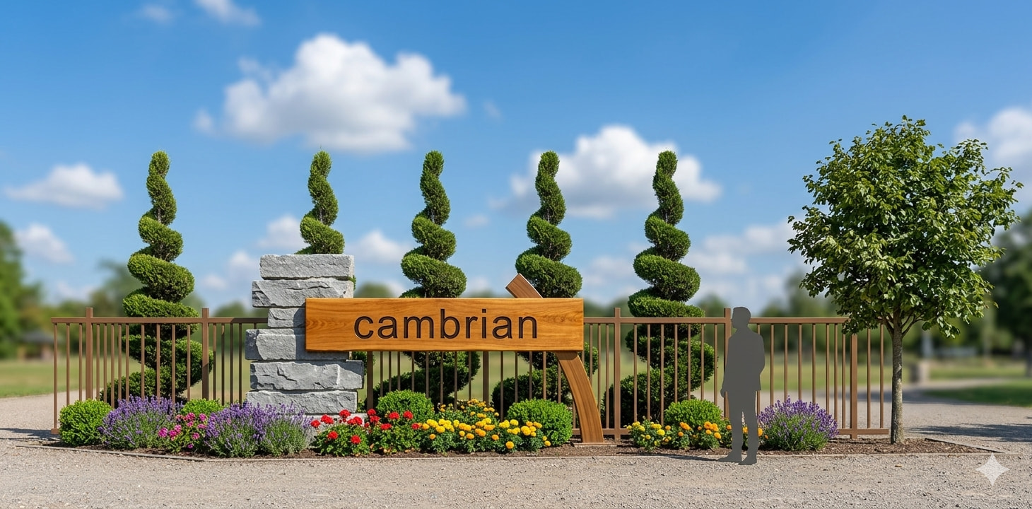

I tried your description above and managed to create a near identical render to yours, one difference I noticed was the figure in the render was facing the camera in mine, where yours had their backs to the camera.

Thanks @mihai.s and @patrick.c.obrien for refining the prompt and reminding me that withe the right inputs, you can get better outputs. I’m obviously a control freak who, regardless of how fast or high quality the result is, I’ll still be irked by the fact the wood sign and rocks have a patina suggesting age whilist it’s a proposal for a new build. I know I know! we could re-prompt it to make it look like it was just installed yesterday rather than 20 years ago if we wanted :stuck_out_tongue:

It took me some time to find the English terms (worn, edge wear, weathering, scratch, etc.) and then to look for tutorials and learn to procedurally create with geometric nodes in Blender and the equivalent in V-Ray those materials that show the effects of passing time and weathering, so the first option was to explain to Gemini what type of materials I wanted for that sign (stone, wood, metal).

:slight_smile: The variant without the effect of weather on the sign or the fence.
