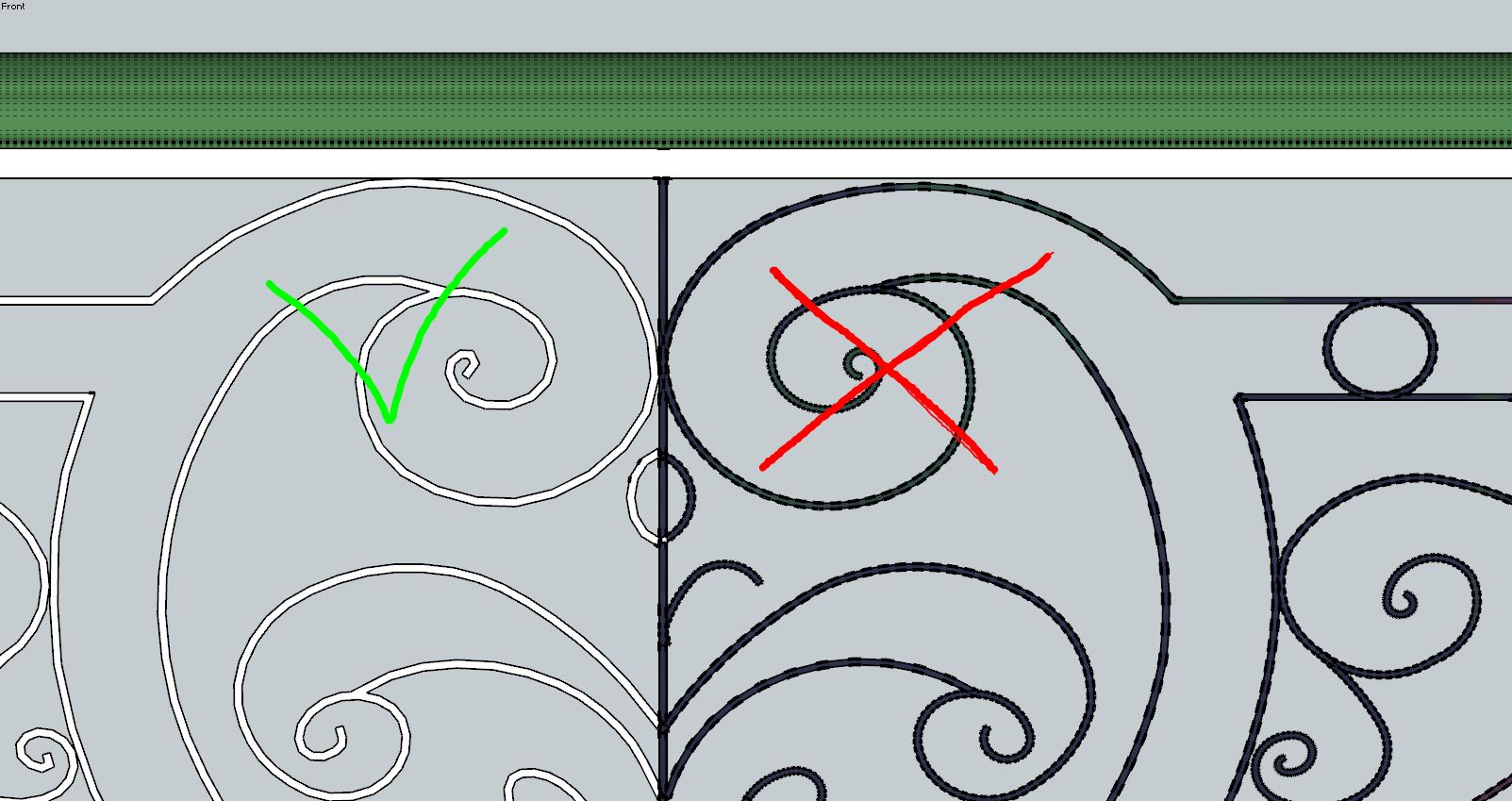

For people who end up with files that they can no longer open because they are already over 500 MB, and the model inside them would probably not have to exceed 15-30 MB, you can consider reducing the number of segments in Arc (3-4 instead of the default 12) and Circle (6-12 instead of 24), especially for objects where you have a bevel, and it is only 0.5-2 cm, 12 segments are pointless, not even when rendering.
13809 entities (left) vs. 2052 entities (right)
546 entities (left) vs. 234 entities (right)
also don’t model the inside of a closed pot / jar.
it doubles the amount of geometry for pretty much added value.
You’re right, Pierre! Thanks!
frying pan
1450 entities (left) vs. 51443 entities (right)
