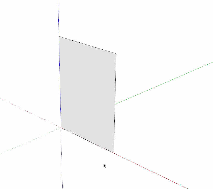

Hi folks, hope all is well! I was wondering the best way to draw door and drawer panels like the screen shot attached? I know there might be numerous ways but not sure the best and fastes?

Do you need to show the individual pieces that go into making the door or is a single piece suitable.
If I were doing a single piece door I would probably draw a rectangle, give it thickness, Offset to outline the panel. Offset again for the width of the beveled edge and then Move the face of the panel in using Autofold.
You could also outline the panel, push in the face and use Scale to make it very slightly smaller for the bevel.
Great!!! Thanks Dave! I never knew of this
