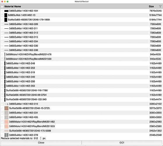

The model is imported from other software. Most of the faces are divided by hidden edges.
There are 21 million edges and 13 million faces.
Textures are incredibly big
This is the file after reducing the textures but it’s big too.
This is after simplifying faces to 50% (could be different than the original one)
1,8gb but it’s version 8 so in version 24 it should be about half.
nothing to purge, oddly. but 136 materials are above 500px
(and many are just… black.)
