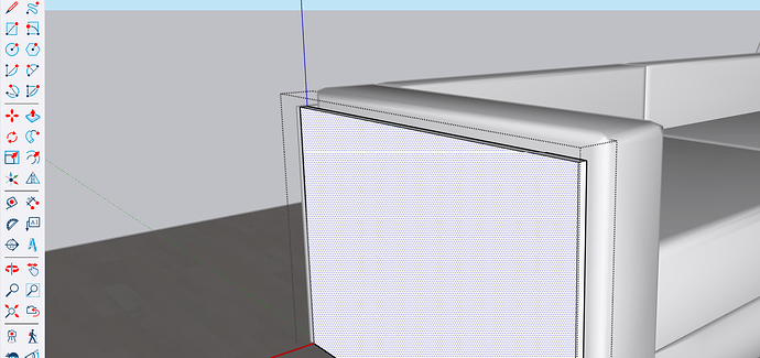

I’ve recently upgraded to a new laptop and am experiencing a minor but obnoxious glitch, whenever I click anywhere in the workspace, the drawing expands slightly across the middle of the screen, by like a pixel tall maybe, and then returns to normal. There is a small black line that is visible across the top of the lower notification bar in sketchup that momentarily vanishes when clicking the workspace, it seems as though that line disappearing causes the workspace to momentarily expand to fill that space during the mouse click. I’ve tried so many things to fix this, spent hours adjusting graphics settings in Nvidia (RTX 4060) with no fix. The only solution I’ve found is to revert back to the old Sketchup graphics engine, which isn’t really a solution at all. This wasn’t a problem at all with my previous laptop with AMD graphics, it’s only appeared on this computer. Any ideas would be greatly appreciated!
The horizontal diagonal shift across the middle of the workspace seems to have some correlation with the scaling in windows, if I set the screen scaling to 150% the issue goes away. 125% is as high as is recommended and making it larger is pretty absurd looking, so again, not a reasonable solution. I’m not experiencing this issue in any other applications

Had some time to play around with this after the last windows update crashed windows… So I figured out that if the laptop is in 1920x1080 (the recommended and highest resolution), the scaling of windows is set to 125% by default and if I have sketchup windowed, the issue goes away completely, even if its windowed to nearly the extents of the screen. If I lower the laptop resolution to the next lower setting, 1760x990, the scaling of windows changes to 100% and sketchup works correctly now when the window is maximized, but the issue now occurs in windowed mode. Also, sketchup crashes when switching windows screen resolution, it doesn’t like that. Probably just going to live with one of these solutions at this point
