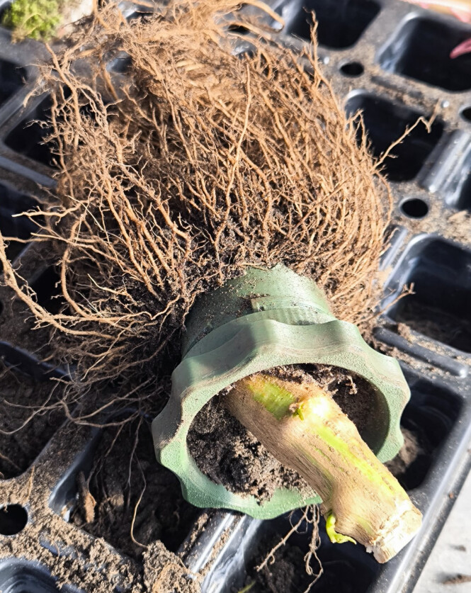

The tomatoes quickly became too big for the hydroponic towers, so I planted some of them directly in soil using the inserts. They filled the holes nicely with their roots…
