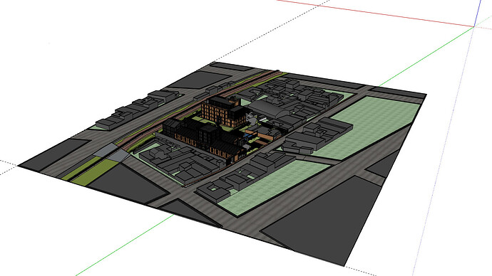

I see incorrect tag/layer usage. I fixed that here.
And there’s a huge quantity of unused components and materials that should be purged.
Looks like it’s time for you to upgrade to the current version of SketchUp.

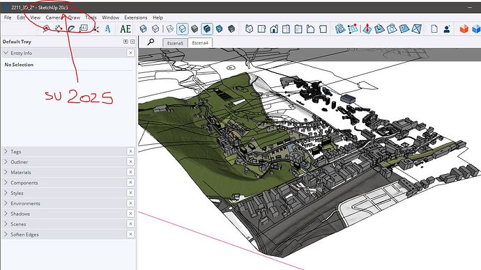

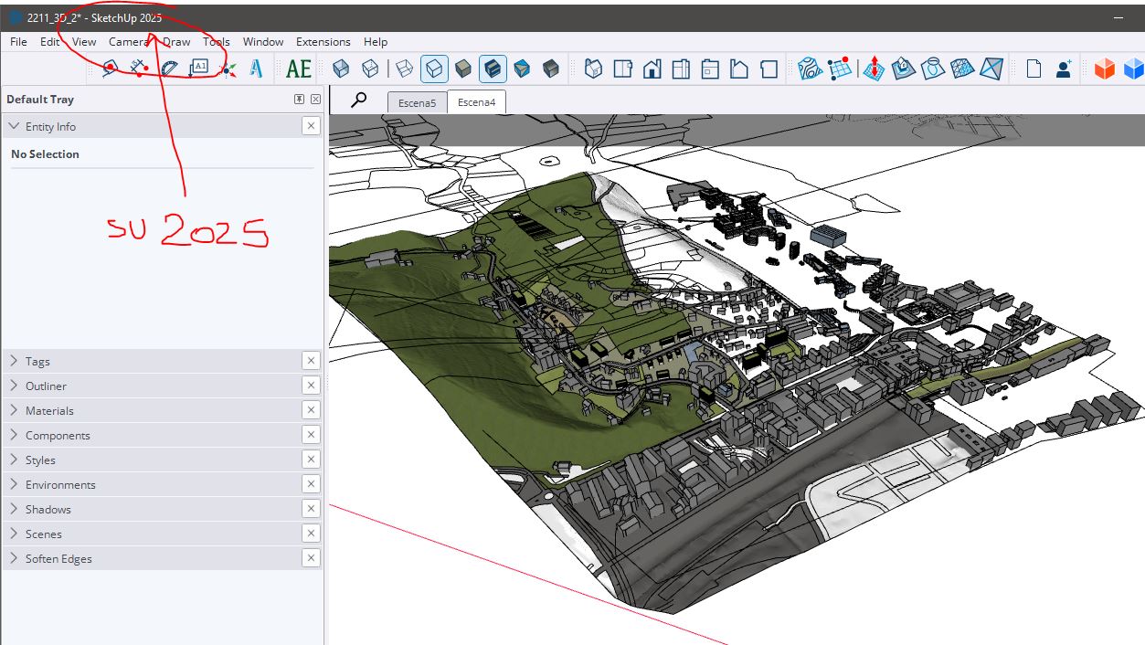

Open it in SU2025

Once you get it open you should take some time to clean up the file and move things closer to the origin. As it is you’ve got it spread out over almost 7 Km.

The file opens with SketchUp 2025 with no error messages. If your profile is correct, you should update to v.2025.
