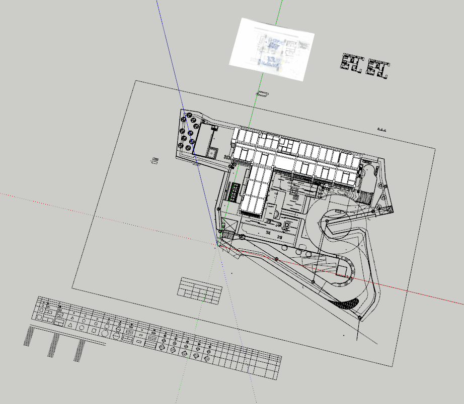

I’d say the main issue is your cad imports. They are probably referencing an origin on the other side of the world. You are seeing the flicker of a classic huge distance graphic issue. Which is why I asked how far from the origin.
Not to mention lots of hidden things at a significant distance from that which is visible. Just looking at the bounding boxes makes me wince.
I don’t have time now to go through and work out what is actually happening in your model, someone else may.
Getting rid of the cad components and moving things to the origin may fix your issues.

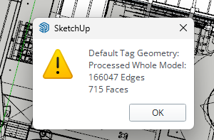

In addition I went through the model and did my usual cleanup process. I fixed incorrect tag usage. In SketchUp all edges and faces should be created and remain untagged.
The bulk of the tagged edges are probably due to the CAD import but the incorrectly tagged faces would have all been created in SketchUp. That can create problems for you later. Leave all edges and faces untagged. Give tags to groups and components.

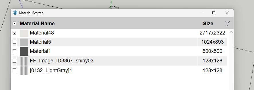

I purged unused content.
And reduced the excessively large texture.
