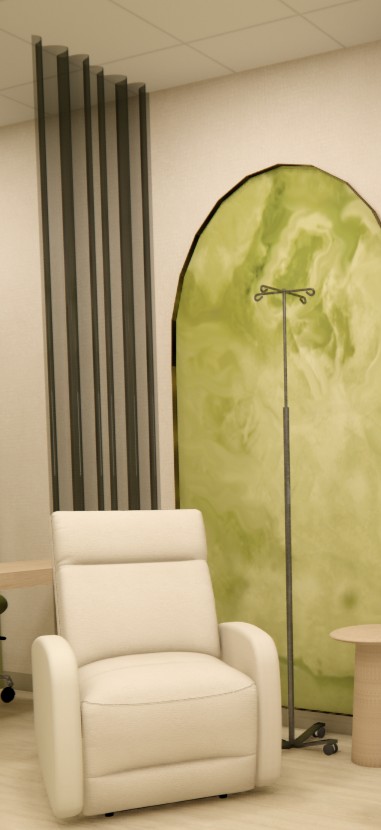

So I have a view in a model that I have rendered before with no issues and suddenly now, the curtains are not rendering correctly. See images below -Sketchup view showing green curtains. And then new Enscape rendering with curtains suddenly looking gray. What’s going on here?
I thought it was a memory issue so I closed everything on my computer and restarted and it is still happening. When I pasted the curtain into its own sketchup model, it renders fine. So I am assuming its a memory/file size issue with my model. I have purged the file, saved it. Do I need to run a more intense clean of the model?

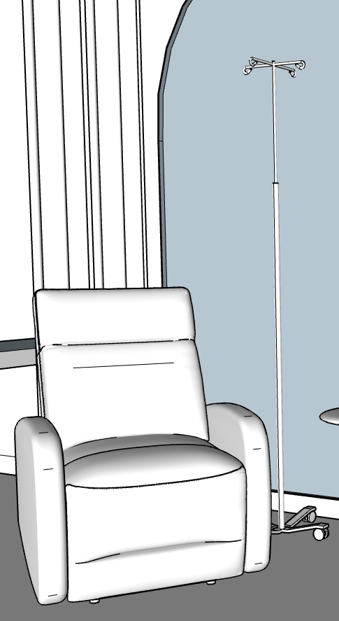

Show the SketchUp model with the face style set to Monochrome.
thanks for the fast response:
The arch paint has its normals inverted, everything must look white on monochrome.

What does the arch being inverted tell you? That is a texture that I placed on a surface. But that renders fine in Enscape. It’s only the curtain that I am having an issue with.

On the monochrome screenshot you shared, the arch looks blue, that means that the normals are inverted. I guess you have more inverted faces on your model, if you share it we can check what problems you may have on your model.
