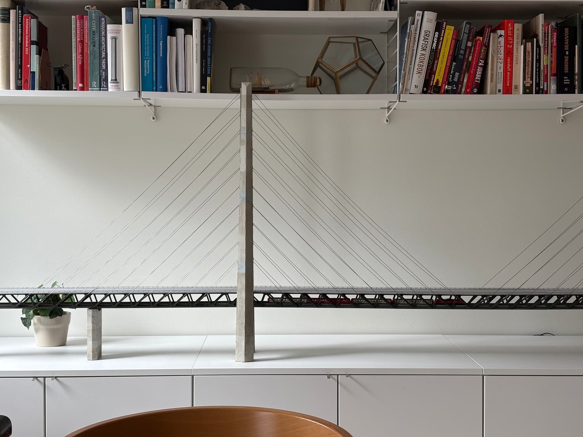

There’s been a bit too much slack in the cables. For simplicity, they don’t take any load. But I want them to be straighter and form more of a triangular silhouette, not look like my potted plants when I’ve watered them too much or too little (I never know which one).
I think I’m making some real progress here! The upper connector was designed and 3d printed to give angular support but it turned out it didn’t really do that unless the bend at the end of the cable is adjusted slightly. I’m also adding tight holes with a snug fit around the cable at the lower end to get the angle right there. Previously they’ve just laid loose on top of the plywood.
If it’s stupid and it works it ain’t stupid. Using a slightly unconventional jig (?) of a book and a custom number of pages from a notebook to drill tiny holes through the center of these guys
Controlling the angle at the anchor points does wonders to reduce the slack.
Before:
After:
The cable stays now also form a nice continuation of the lines in the truss.
Looking so much better with the cables installed!

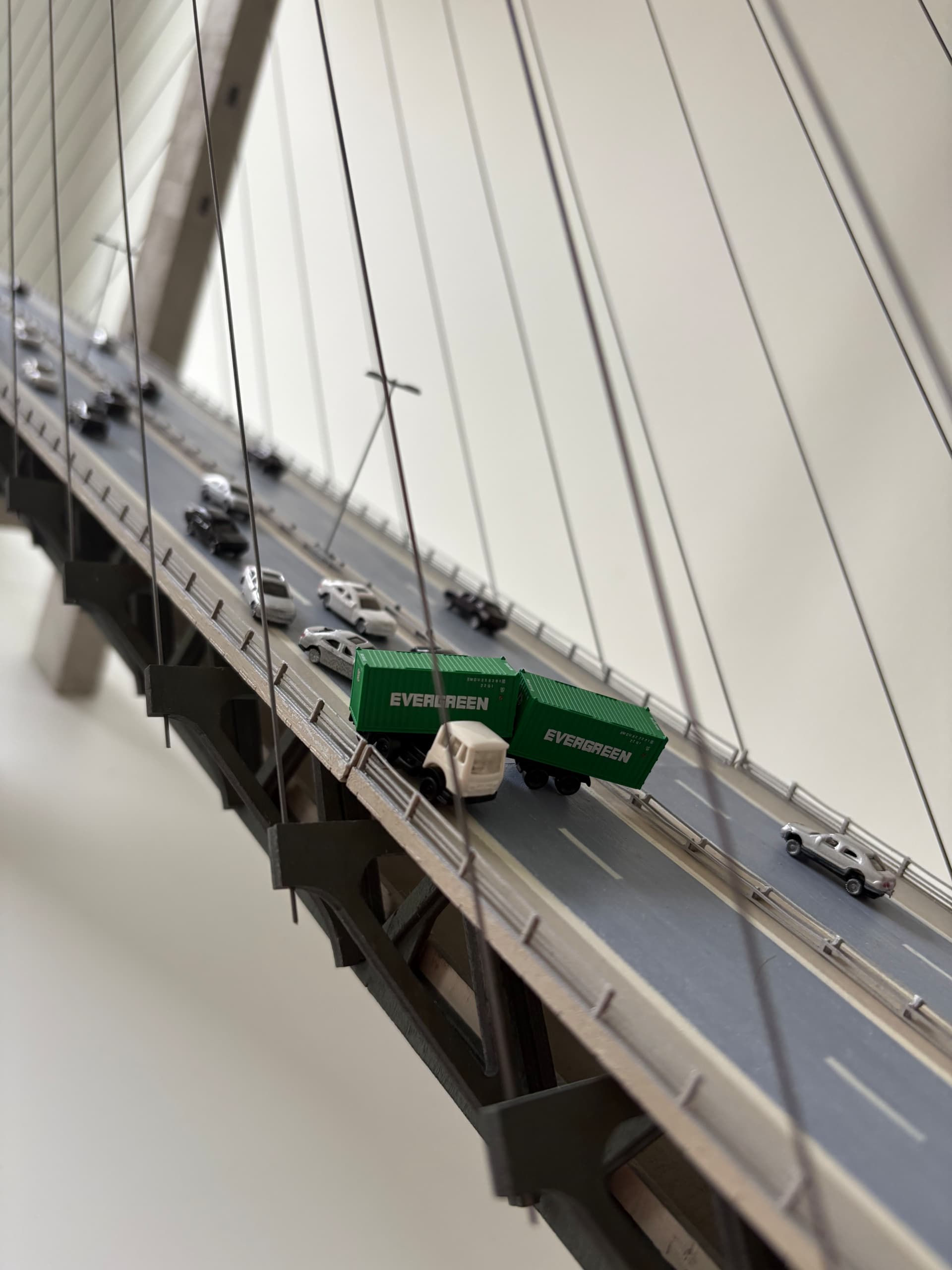

And so much better now with a center barrier and the roadway actually being blocked off from side to side :smiling_face_with_horns::face_with_hand_over_mouth:
Well played!
this is a 2020 meme. the kind of stuff we’ll see in 10 years, and kids will say “I don’t get it, this is no skibidi”, but the ones that were stuck in their flats in the spring of 2020 will chuckle .
It has rizz
I watched a documentary where they deliberately set that up to happen. Cars and trucks were all driven by remote control, and all the car drivers weren’t given a clue that there was going to be a jackknifed truck happening in front of them. A very interesting and complicated experiment.
