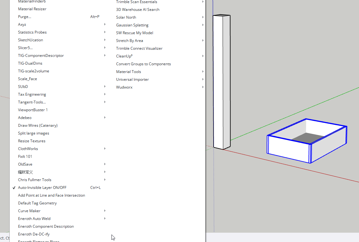

I downloaded and installed the De-DC-ify extension, but no matter what I do I the tool remains grayed out and cannot be used.
Is anyone currently using this extension on the newest version of SketchUp?
Has anyone experienced this issue?
Any advice @eneroth3?
Having it grayed out in the menu implies that you either haven’t selected a component to De-DC-ify or the component you selected isn’t a Dynamic Component in the first place.
What operating system are you using? “2025” doesn’t identify an operating system.

Thanks for the reply. I have selected the object in different ways because I was thinking the problem was what you mentioned. I am using Windows 10. I am new to SketchUp, so it is possible they are not dynamic. I assumed that if I made it a component, it was dynamic. Also, there is another extension that isn’t working properly, and it said the problem might be caused if your components are dynamic, then it won’t work. This is what led me to download this extension in the first place. It is a bit of a rabbit hole.
A component is not automatically dynamic upon creation. You would have to give the component dynamic properties first.

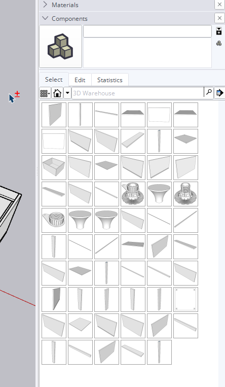

None of the components in your model are dynamic. Note the lack of the green icon in the component thumbnails.
Here my drawer box components in this collection have the green icon because they are dynamic components.
