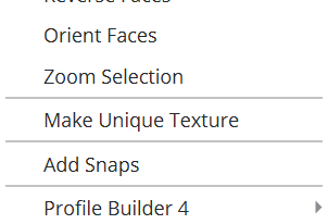

Hi, I am using Sketchup Pro 2025, version 25.0.660 64-bit. I wanted to try snaps for the first time and had no problem adding one. The issue is that I can not Edit or erase it, only “Add Snaps” is available :
right cliking in a blank splace will produce the same result.
Select the snap(s) you want to remove and press Delete.

Thanks a lot, Dave! I tried in a new project and it worked :star_struck:, so I realized there was something wrong with the first one. When I made all the tags visible, I was suddenly able to select the snaps. Instead of being ‘Untagged’, they were on a hidden tag… I don’t remember selecting this tag when adding the snaps, but I might be wrong.
