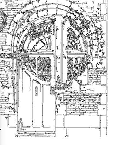

Thanks guys, but unfortunately my window Is art Art Nouveau therefore very organic. I think I will have to cancel this project
I cannot understand why Sketchup does not have splines or poly lines.
I was not hopeful but I tried to convert it To DWG here is what i Got. To be expected though.
I don’t see anything that I couldn’t draw with native arcs or the free beziers curves extension.
and time, off course. a complex thing like that requires time
I just only need to use Arc and Line tool. They are enough for this kind of.
Why don’t you import the image into SketchUp and make it a reference image, then use Arc tool to draw over? Try to use Arc Tool of SketchUp, it’s powerful more than you think. Just click and move the mouse closer with the arc you want on the ref image, then wait for it turn color to cyan or purple then click…, and so on.
