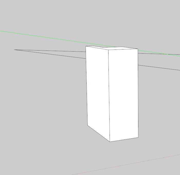

Double Cut Bug
I’m trialling Double Cut 2 and run into a bug – see gif.
Double Cut Bug
I’m not sure if this is related @PaulMcAlenan, but I recently encountered a similar thing after using the MSS BoolTools 2. In my case it was a simple extruded solid with another simple solid subtracted to form a hole. This was done six times in different assemblies. I later had to adjust the opening sizes. In half the openings I found there was a hidden line created which stopped PushPull operating as it was considered a curved or smoothed surface. One vertex of the hidden line was at a corner, the other was a random point along an edge. Initially I thought it was the cutting object at fault until I realised the affected face wasn’t consistent. I have seen this hidden line issue after subtraction previously, but put it down to user error in my modelling. In my recent case deleting the hidden line left the complete face intact, so I have to assume it wasn’t down to non-planar vertices.
