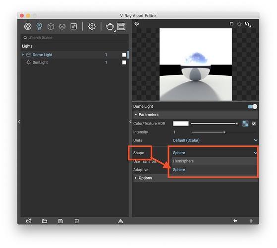

For anyone who’s looking for an answer here in 2020, you need to select “Sphere” in the shape option under “Parameters” for the Dome Light settings.
Thanks @zayd_radzi for the answer. See screenshot to showing where in Dome light to make that change for anyone who is not familiar with the settings.
