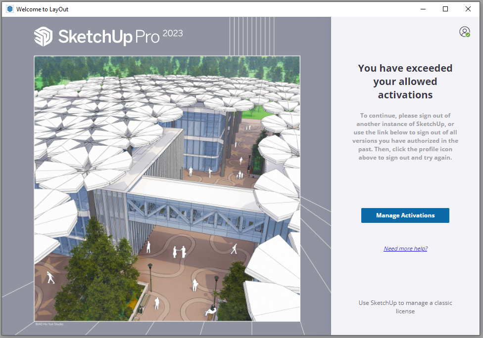

i tried to open a layout file in 2023 so i could back save it for a colleague and it wouldn’t let me sign in said too many activations. MY LICENSE ONLY EXISTS ON THIS ONE MACHINE AND 2035 DOESNT DO BACK SAVES ANY MORE WHY CAN’T I OPEN DIFFERENT VERSIONS OF THIS THING? [— EXPLETIVES DELETED—]

with SU 2025 open, LO 2023 will NOT open, “you have exceeded your allowed activations”
this will then persist even after closing SU 2025 and the only way to make 2023 work is to waste a bunch of time on activations page
