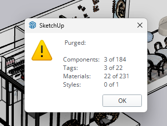

The file opened fine for me. Make sure you have the latest release of SketchUp 2025. There are some components at a huge distance from the rest of the model. I selected and deleted them. I also fixed incorrect tag usage. You should be keeping ALL edges and faces untagged.
I also purged unused stuff.

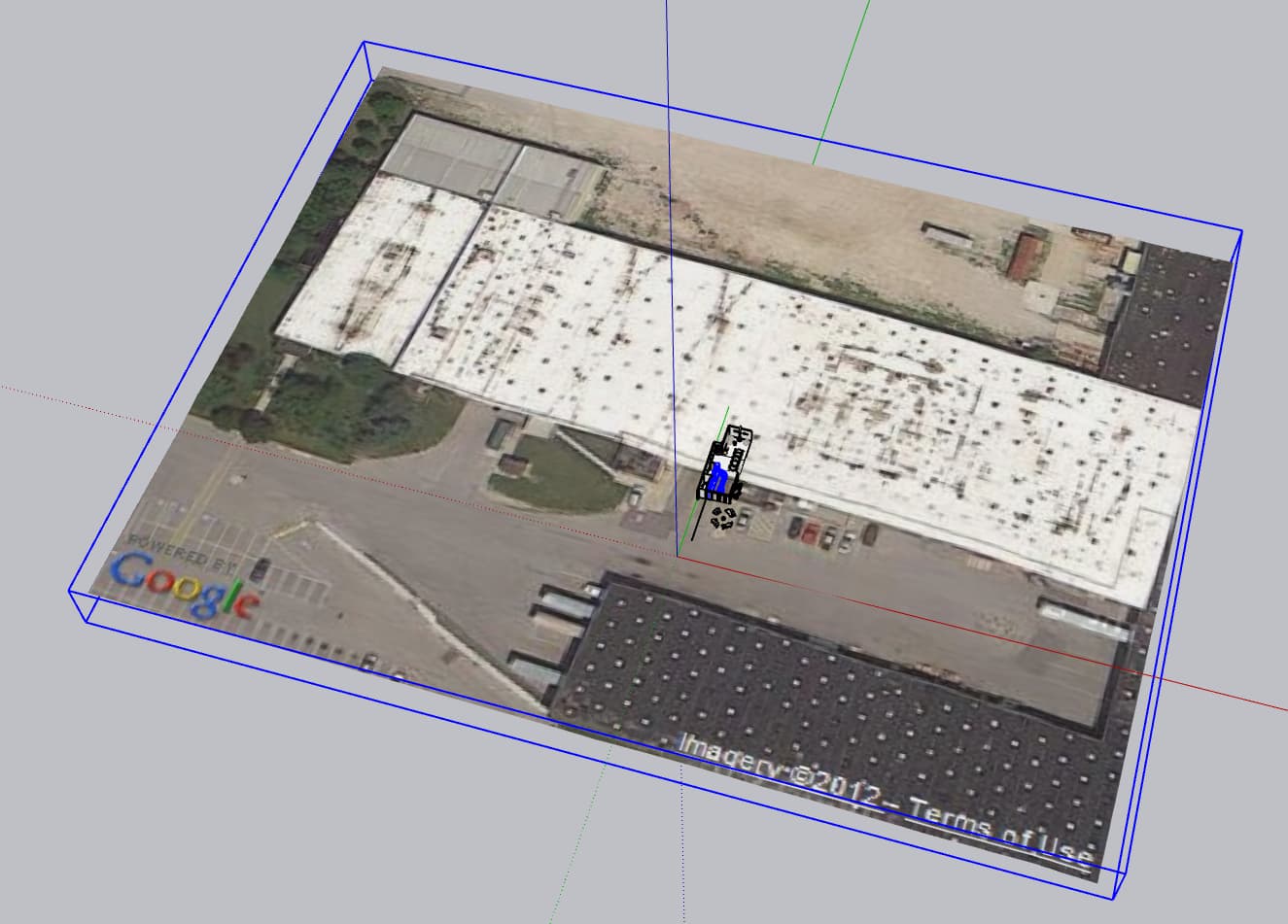

BTW, do you really need the ancient image and terrain from Google Earth? It doesn’t seem to have anything to do with your project.

don’t know what that came from, definetly don’t need it!

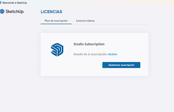

Is your EDU license up to date?
Maybe garbage that came in with something from the 3D Warehouse.
i wanted to check the details but I received the answer from the previous message. It was a yearly license as far as I remember, starting last April
That seems to indicate that you have an active ssubscription.
