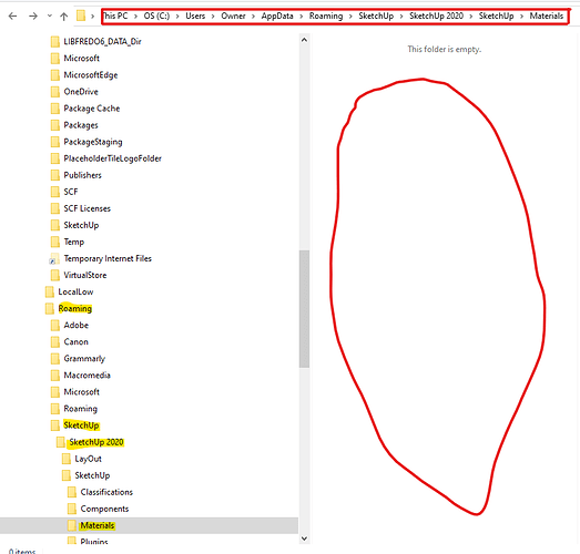

I do go to that folder but I see nothing there. Not like the folders listed in the Materials Tray. (See attached Screen Capture)
When in the AppData>Roaming>Sketchup>Sketchup20XX>Sketchup>
One must drill down, once you enter the last folder the Materials, components folders will be visible.

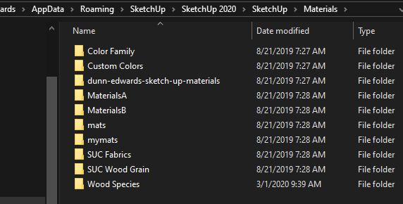

The User/App Data…SketchUp/Materials folder is intended to only contain material files you add. The native folders you show are stored elsewhere. You can make subfoldersin your Materials folder if you like. I have sub folders for things like Wood, Fabrics, and other things. Then in my Wood folder I divide it by species so I have Cherry, Oak, Walnut, Teak, etc.
I followed that path Dave, and I see nothing. What am I doing wrong here?

Nothing’s wrong with that folder. Unless you add materials to that folder, you shouldn’t expect to see anything there. Like I said the OEM materials are stored in a different location. Here’s mine. All of these folders are of my doing.

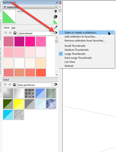

Thanks again Dave, How do I remove the listing at the bottom of this listing in the picture? Do all your folders show up in the Materials tray? How do you get them to do that?
The folders in the User/App Data folder will show automatically if that’s what you have set up for the Materials location in Preferences. You can see the folders from mine, above in the drop down.
To eliminate the folder from the list, you need to find where you put it and delete it. I deleted the one called mymats which I’d made in a lesson with a student. Then I reopened SketchUp and it’s gone.
