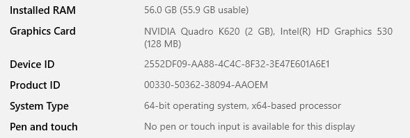

what does it tell you ? is there an error message ?
also, you should probably edit your message and remove the image. you’re displaying your device and product ID.
