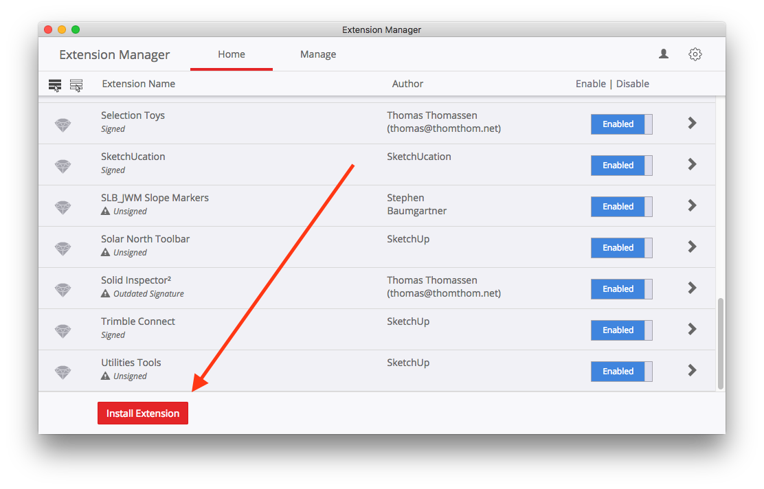

Are you talking about dragging it to a directory using Windows Explorer? Itâs easier to use the Install Button on Extension Manager window than doing it manually.
Please explain what you mean by âmapââŚ
You install any extension using its RBZ file, which you have downloaded and which is then loaded using the built-in âInstall-Extensionâ red-button - available in the âWindow > Extension-Managerâ dialog [in very old SketchUp versions itâs accessed through the Preferences dialog]
Itâs a simple processâŚ
Everything is automatically unpacked into the correct subfolders in your userâs Plugins folder.
What the other two said would work, but as the extension is in Extension Warehouse, just open that from the Window menu, sign in, then search for SketchUp STL. Use the Install button and it will put things in the right place.
