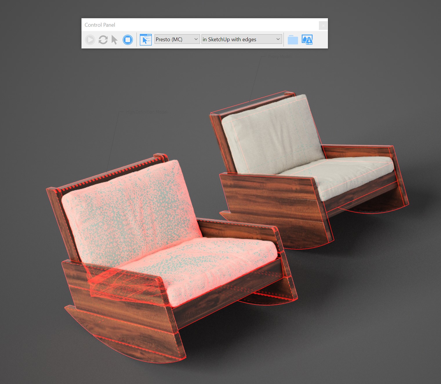

And that makes your point. However, now I have to also make mine clear.
This is what a very high definition model looks like in the left. That is plainly wrong if you want to display it in Layout, for instance. But it’s what you need if you want to create photorealistic renders.
So I build simple enough proxies of the models I need as the model in the right. Most of the times I use the same chair proxy model for every chair model I have, but this one is a special case where I built the proxy as I wanted it to show in Layout for my interior design.
The proxy in the right is a placeholder for the model in the left. The model in the left doesn’t have to exist in the model for the placeholder to render it instead. So the model is very lightweight and when you hit the render button the proxy is replaced by the high definition model at render time. And it looks like this:
Some render engines support this, some might not. I’m using Thea (https://www.thearender.com/) and rendering inside Sketchup so I can overlap render and sketchup and you can see the differences:
