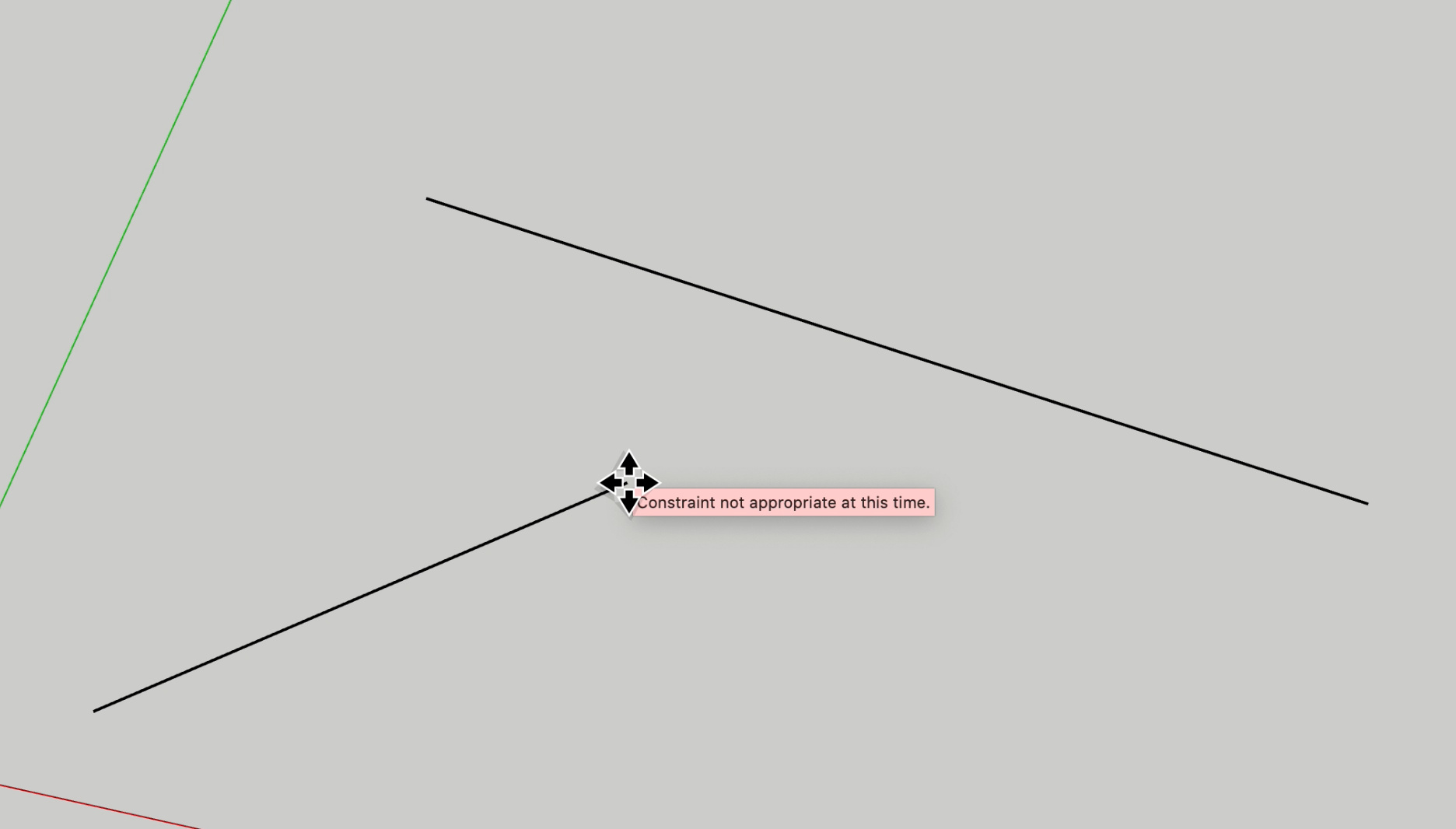

a drawing software in 2020 with not trim or extend feature. how disappointing. I feel bad for all architects out there.
just fix it. I don’t want go to all kinds of sales homepage just to install plugins.
who can recommend me another software I can use and install instead of this?

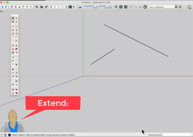

extend:Extend edge

@chefen, or apply the ‘Move’ tool on vertices.
Might not be appropiate at this time
It is though!
