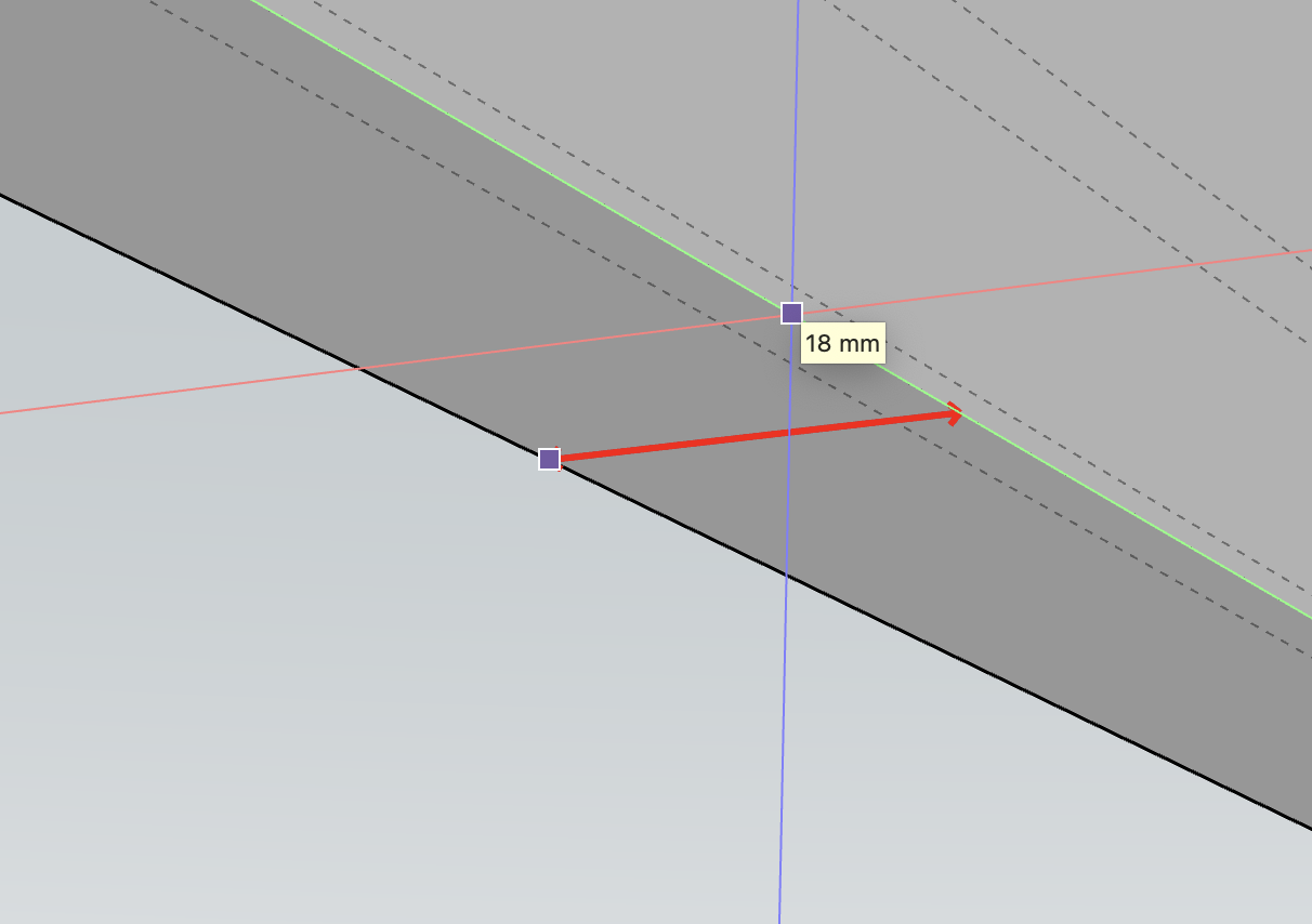

First timer trying to modify a design. I have attached a file with one of the sides of this cabinet in the model that I would like to change to highlight my challenge.
I want to adjust the width of the panel from 19mm to 18mm. When attempt to using the move or push/pull tool the 45 degree ends and the drill holes don’t adjust accordingly and a new face is created.
A detailed step guide would be appreciated and/or point me to a reference video of how to do this would be great.
Many thanks.
-Scott
Adjusting width of a panel by trimming (Intersect Faces)
Don’t forget to orient all the faces correctly, with the white facing outwards.
Basics of SketchUp at Campus - learn.sketchup.com
Your panel is not accurate… it is ‘approximately’ 19mm.
@mihai.s shows the way, I would do this with a cutting block and Solid Tools, but its best to learn the Intersect Faces method and get good at it - your panel is not solid, there were some errors I had to find with the mitered bolt holes so I deleted them.
