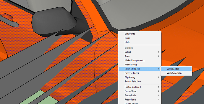

Don’t think about adding stripes as if you were applying tape to the surface of the real vehicle. Divide the surfaces of the door and the fender so you can paint the areas different colors. I set up an array of rectangles that are tilted at 45°. I made a component of the rectangles before moving the whole thing into place. That makes it easier to remove the rectangls when they’ve served their purpose.
Select the surfaces, right click and choose Intersect Faces>With Model.
Remove the rectangles. You’ll have edges dividing the surfaces.
Paint the stripes the appropriate color.
Screenshot%20-%202_26_2019%20%2C%208_02_03%20PM
