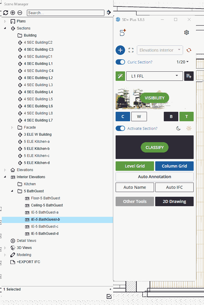

I have created interior elevations with the Curic Section plugin.
The Curic Scene Manager neatly files the interior room views into a dedicated folder automatically - I love that.
So far so good.
Now, what bothers me is: updating the scene with 5D+ (V1.8.5 / 2025.04.20) changes the filing location in the Curic Scene Manager.
How am I preventing this unwanted shuffling of the filing order?
Thanks!

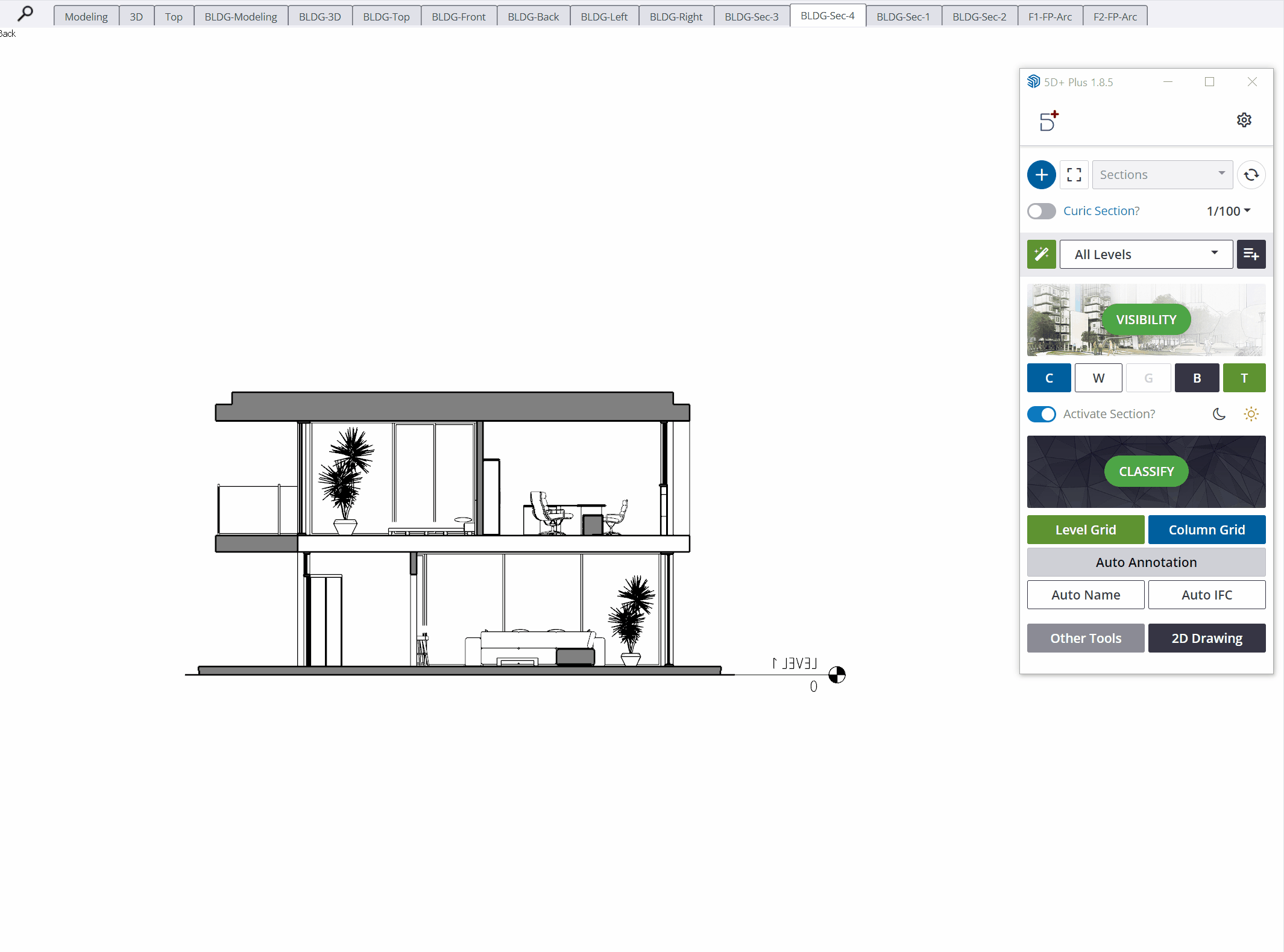

Hello,
I try to use bounding box for resizing the scene, but bounding box doesn’t work for me. I am not sure what I did wrong. After I adjust the bounding box, I didn’t know what button to use to save and update the bounding box.
Thank you!
Hi, as you can see at the bottom of the screen while activating the tool, the instruction says: Press Ctrl+Enter.
Hi, you should close the Curic Scene Mananger while creating or updating the scene.
