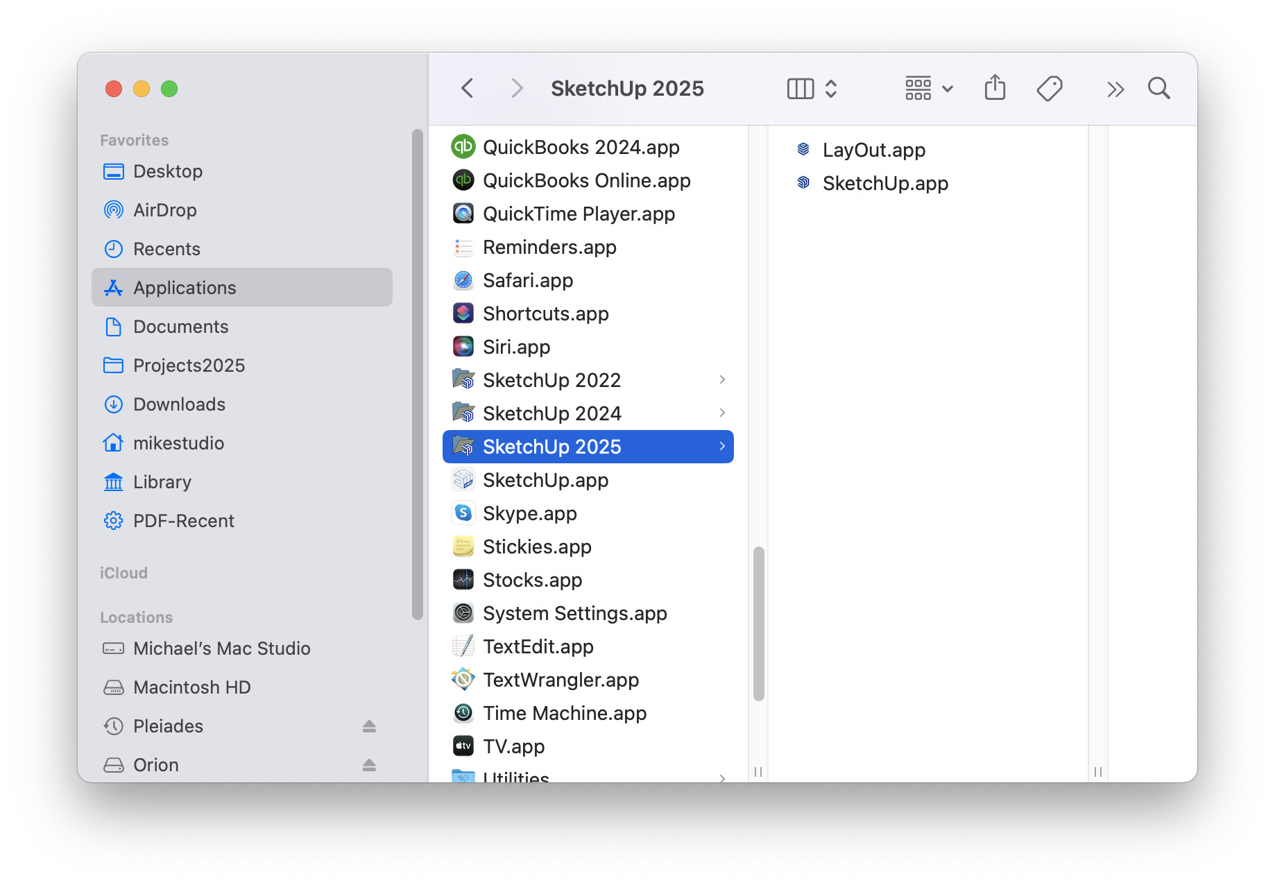

Does SKP live here:

A few versions ago we made a change in the Mac version, so that if you did by mistake run SketchUp from the disk image, it would not upset macOS like it used to. I tested that now, to see if it could account for 3D Warehouse not working.
Verifying and launching SketchUp is slower when running from the disk image, so I would not recommend it! But, it did work, and the 3D Warehouse window opened ok.
To get the message about needing to update should only happen if you are running 2021 or earlier.
So I removed all the old versions temporarily and downloaded the newer version again and installed it. It seems to be working now so my guess is that the app didn’t update on my desktop and therefore was run-in an older version.
