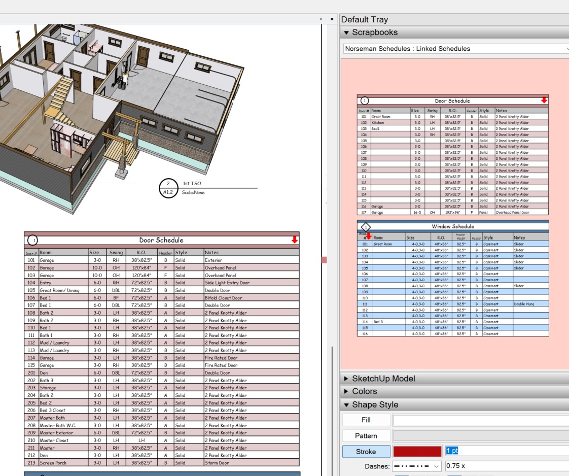

Opening a 2025 file or older My schedules (tables) have a formatting problem with Shape Style/Fill
2025 or older file.
I have tried to edit the table and Fill doesnt work. I opened a blank Layout file created a blank table and still formatting cells with fill is a problem. Using the excel file formatting doesnt work well either. I rely on formatting the table in Layout.

This looks like this is a known issue: Updating Table References may result in the wrong row or column data being updated. This can be fixed by setting the cell range through the ‘Table Reference Options…’ context menu dialog.
But once you untick the “All” option it can’t be reset, which for some of us is a show stopper.
I will look into that. The cell data updates ok. I dont use the Spreadsheet formatting.(an area that could use a looking into). Does that affect the fill of the cell? Im just pointing out what I have found and will expect the next update will hopefully fix things. The reply is appreciated.
The team is working towards patch/release in the near future, hoping to have this fixed as soon as we can.

It looks like we’ve introduced a bug in 2026 regarding the fill color of tables. After some testing, I’ve found the issue is only a problem with empty cells. Any cell with a value should accept fill color. I’ve logged a bug internally so we can investigate a fix.
There’s an issue with a mismatched installer for V-Ray. We’re working on correcting it now.
@ajeffers It is also stripping already created tables. In my post above shows where random cells are stripped and editing into them wont let you fix it.
