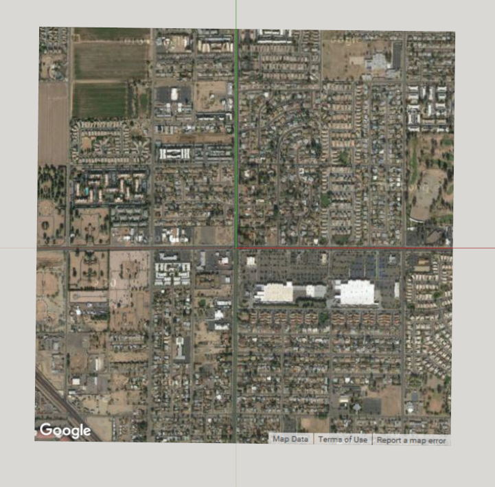

Can I enter coordinates (2d) into SketchUp (Could be UTM or Lat/Long)?
I used Google Earth to create a placemark in the center of an intersection where the roads are aligned almost exactly to true N/S and E/W. Using the coordinates of the placemark, I used the “Model Info >> Geo-location >> Set Manual Location…” followed by “Add More Imagery…” and got this as a result:
The imported Google Earth data is located at the origin of the model and the orientation of North is along the green (Y) axis.
